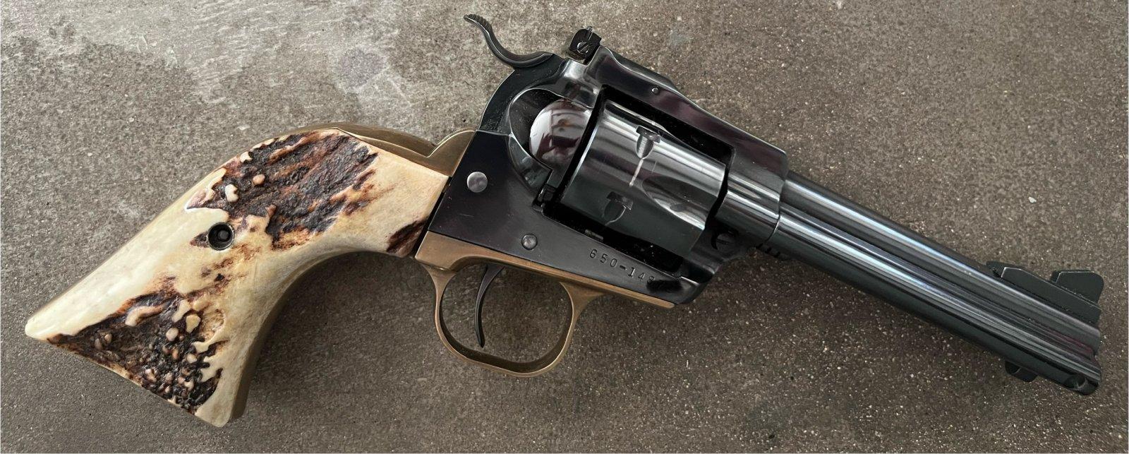

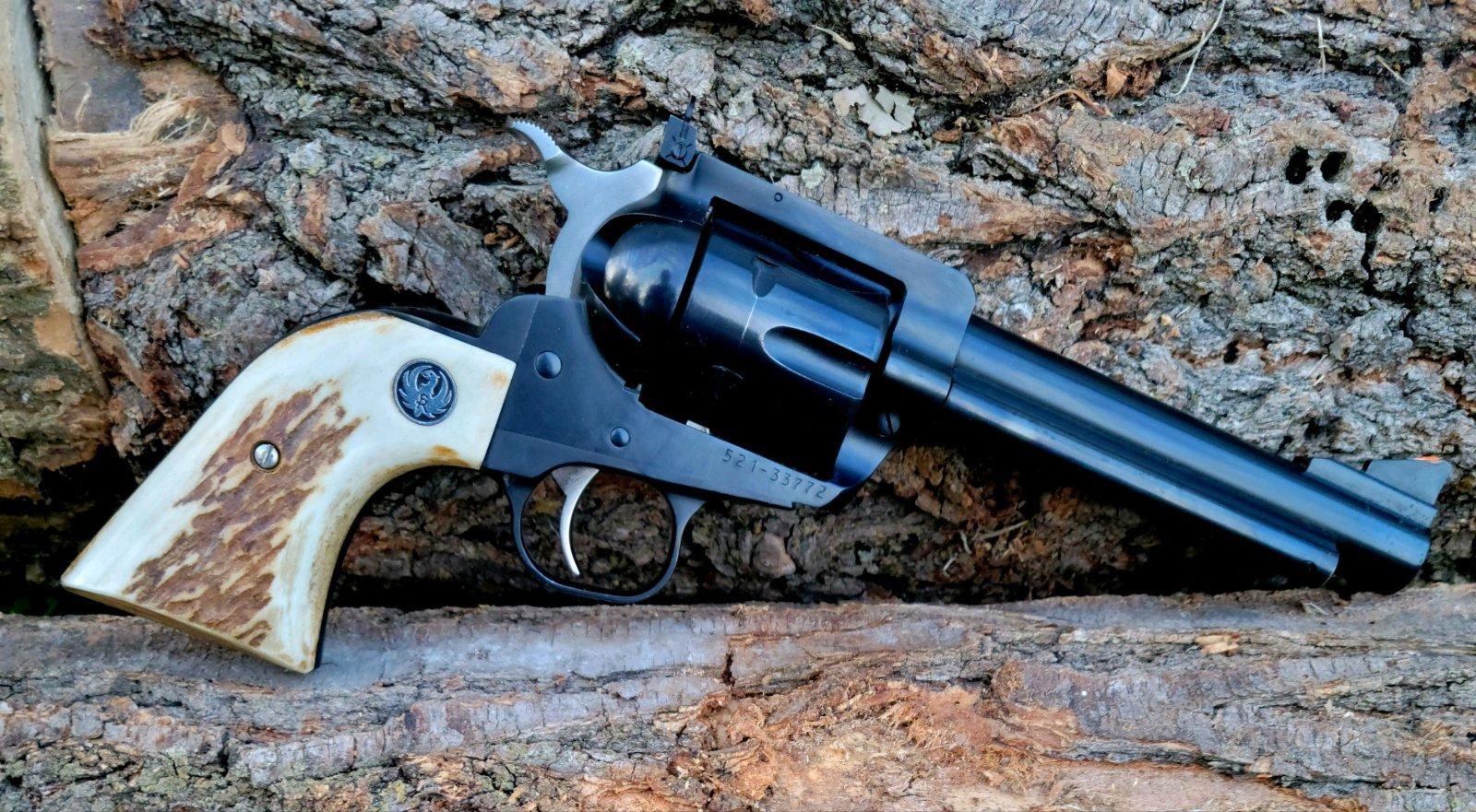

New Stag grips for my 32 H&R Magnum.
Built this one years ago, never really cared for the fit of the original grips, they were just a little off.
Stag grips can be hit & miss,,, but I did like the initial look of these.
After a little adjustment this morning, these have a new home…😁
Please feel free to show yours.
BIG shout out to member SWRZR … Acquired these Stags from him this week and the transaction went flawless.

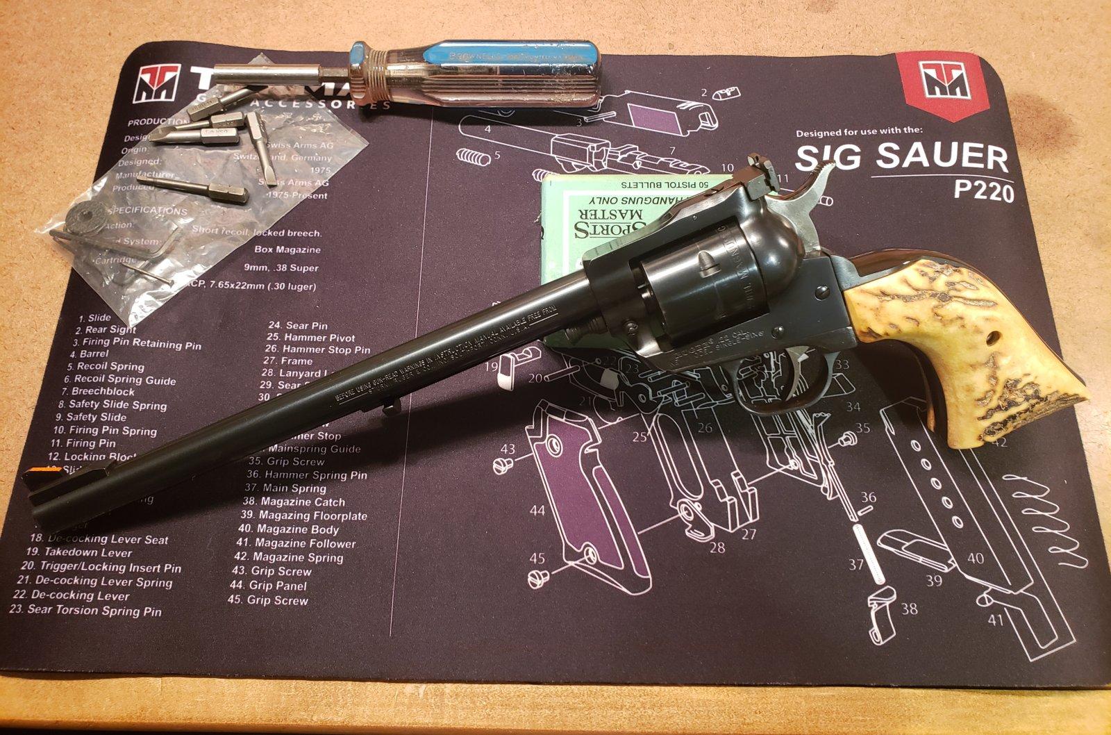

I put an older Ajax set on this S6, which also has a steel GF, as well as a few other add ons. It's my favorite shooter of my 3 single sixes. Only shoot it with the mag cylinder and shoots better than I'm capable! Yours definitely has nicer bluing than mine. Best of luck with it, looks great! Bill in MA

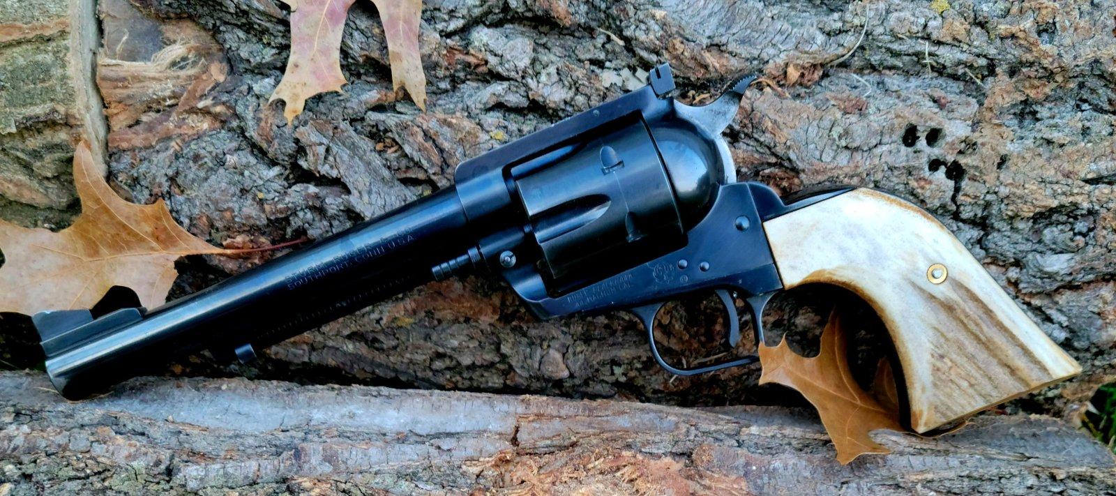

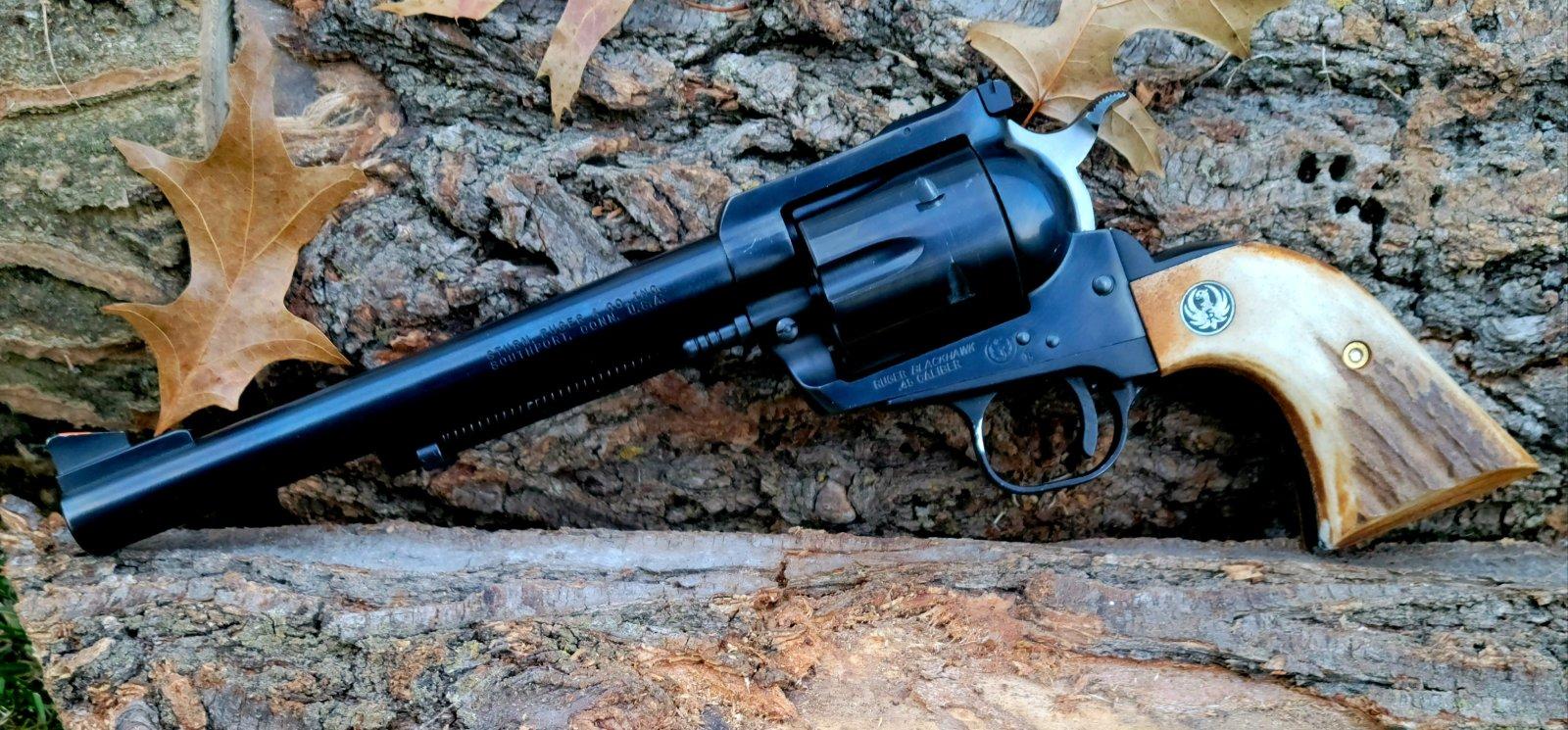

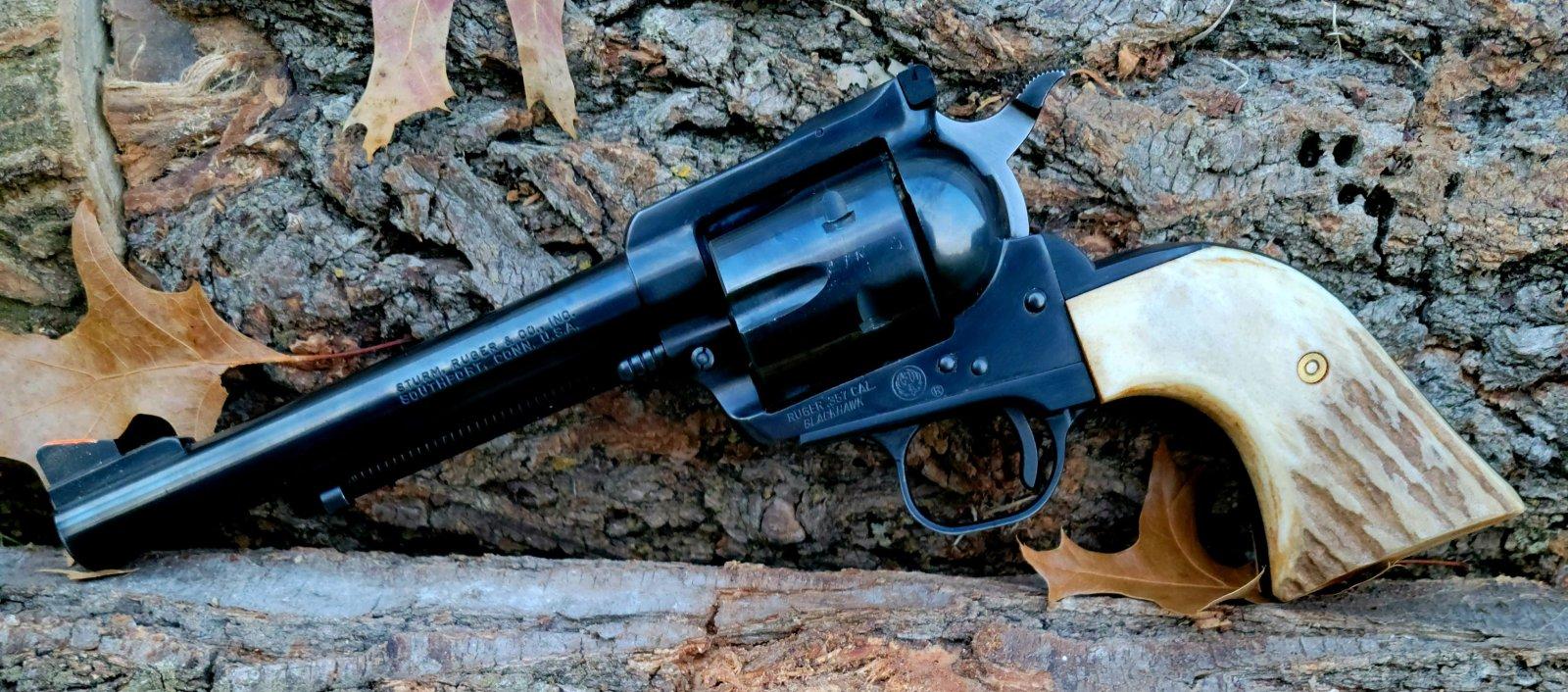

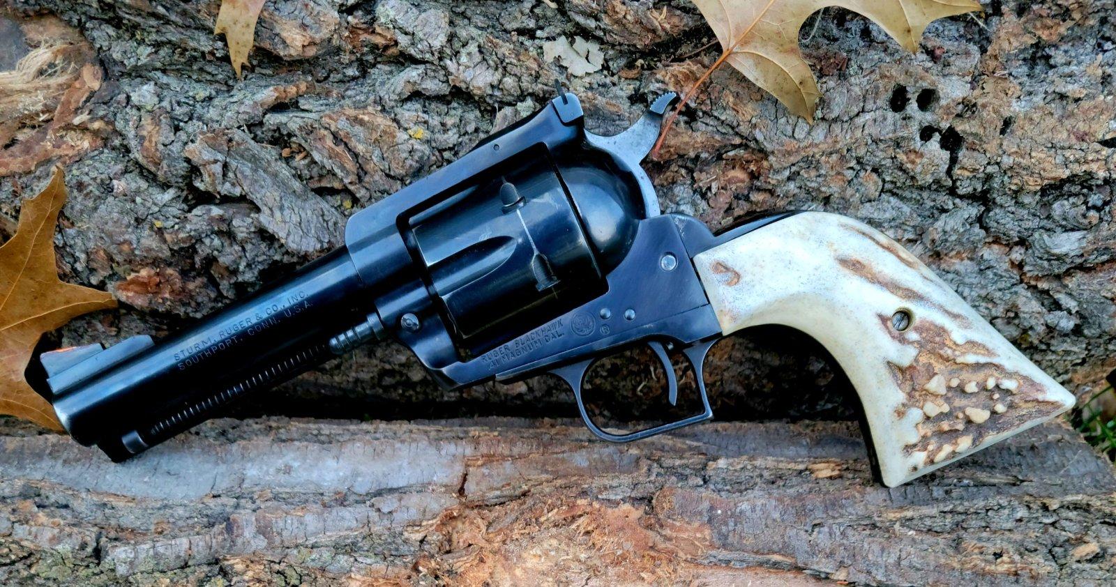

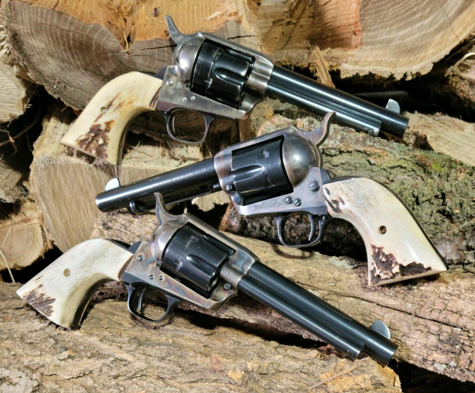

Oh my, Stags! My favorite!

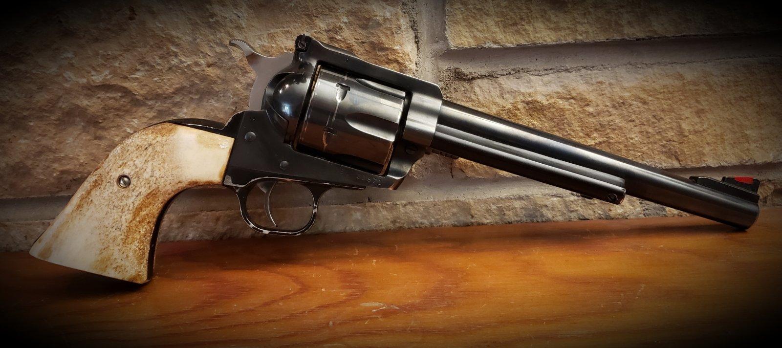

NM .30 Carbine
.44 SP Flattop
NM .45 Flattop
OM .41 Mag
OM .44 Mag Flattop
OM .45 Colt
OM .357
And that's Just the Ruger's!

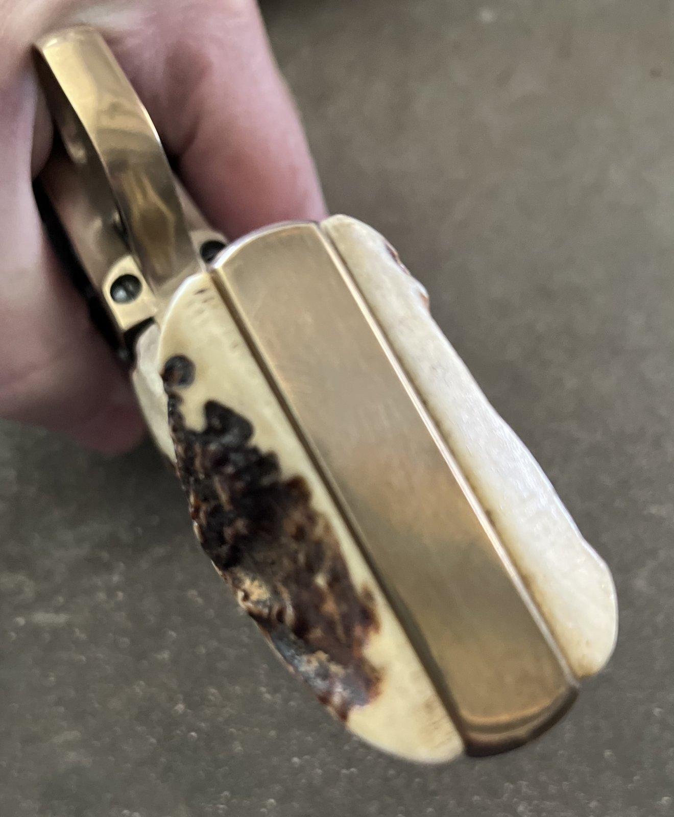

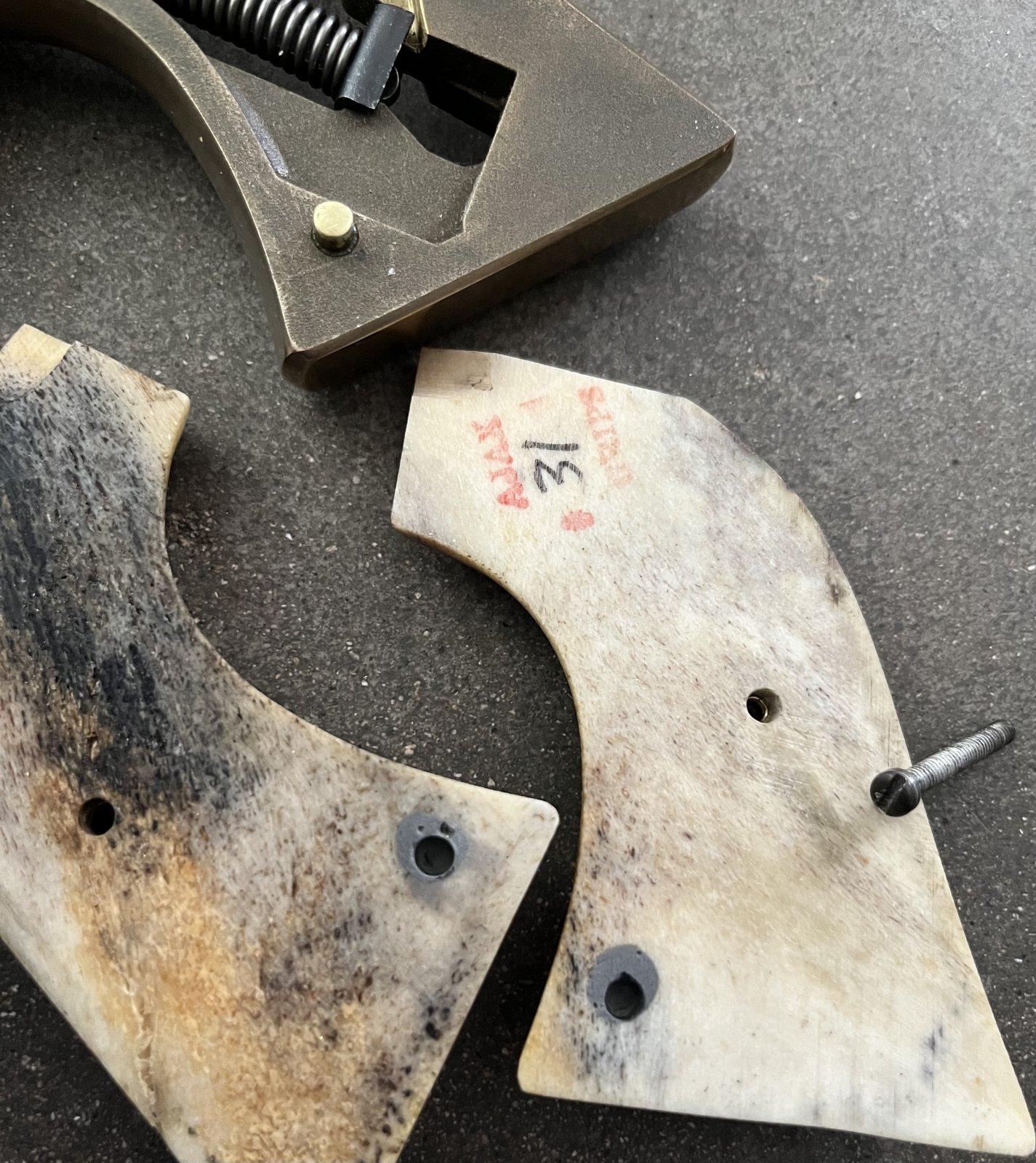

They were close but the locator pin location on the Qualite G-frames was always a bit off. The Stags had oversized holes so I went ahead a bedded them in. The rear of the grips was a little proud of the BGF, A 240 grit Diamond file fixed that.
I was willing to re-do the BGF to fit the Stags, but really like the patina this frame is developing, and was sure pleased that it didn't need any adjustment.
Picture of the grips as listed.
After showing the bedded locator holes bedded. And touched up the screw, it was buggered a bit.
Adjusted the tails just a bit, they were proud.
The grip frame was fit in 2008, 16 years of patina…😉
