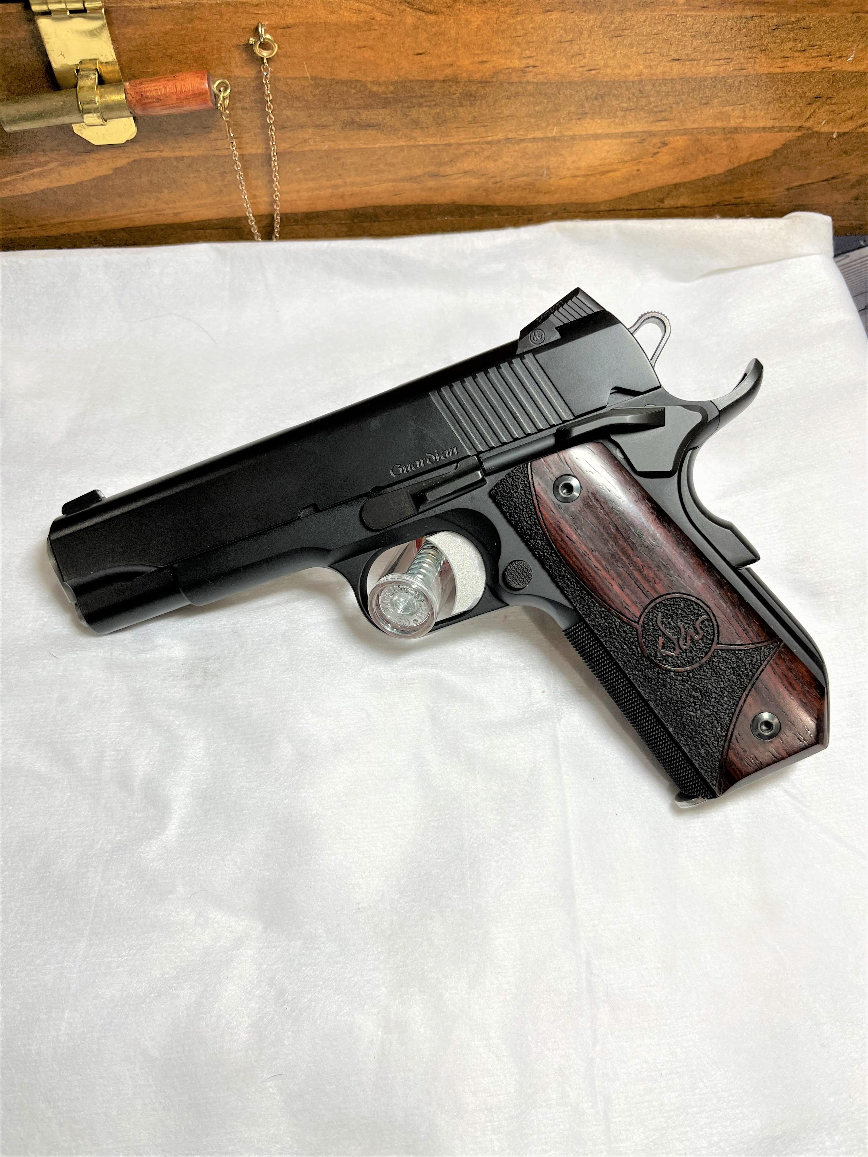

I use my DW Bobtail Guardian in 9mm. I think DW is one of the finest 1911's made today, bar none!
