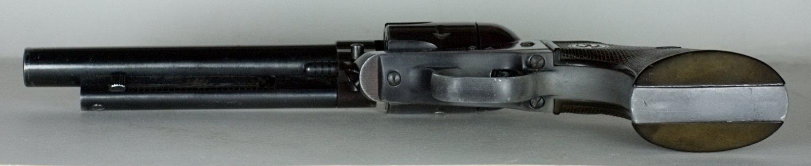

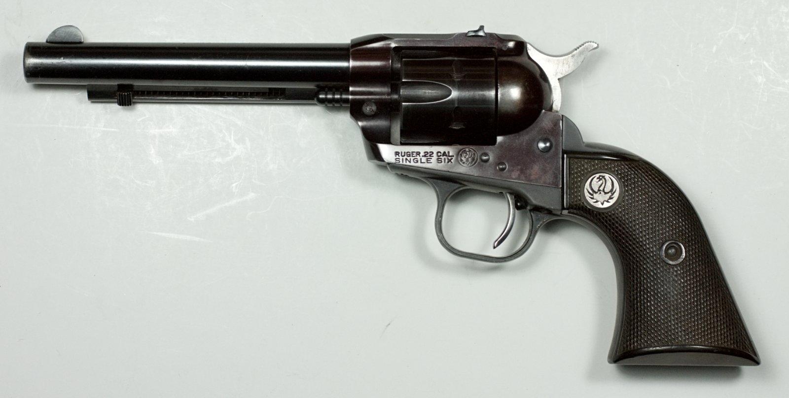

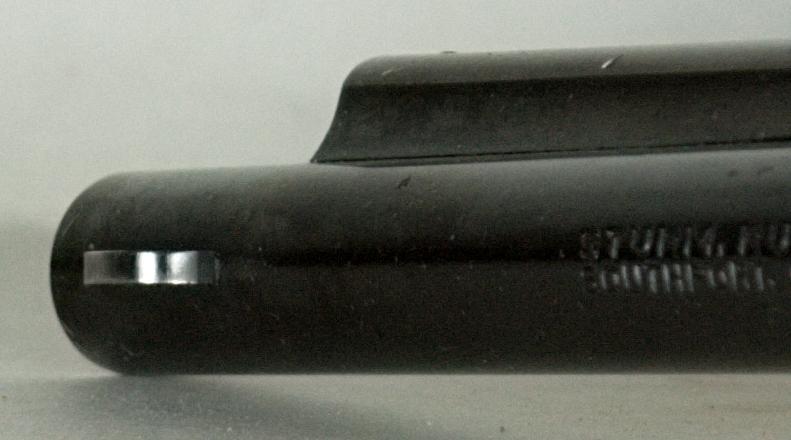

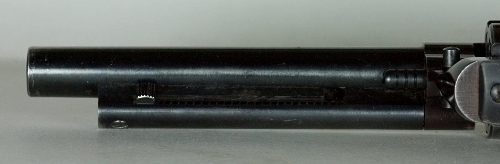

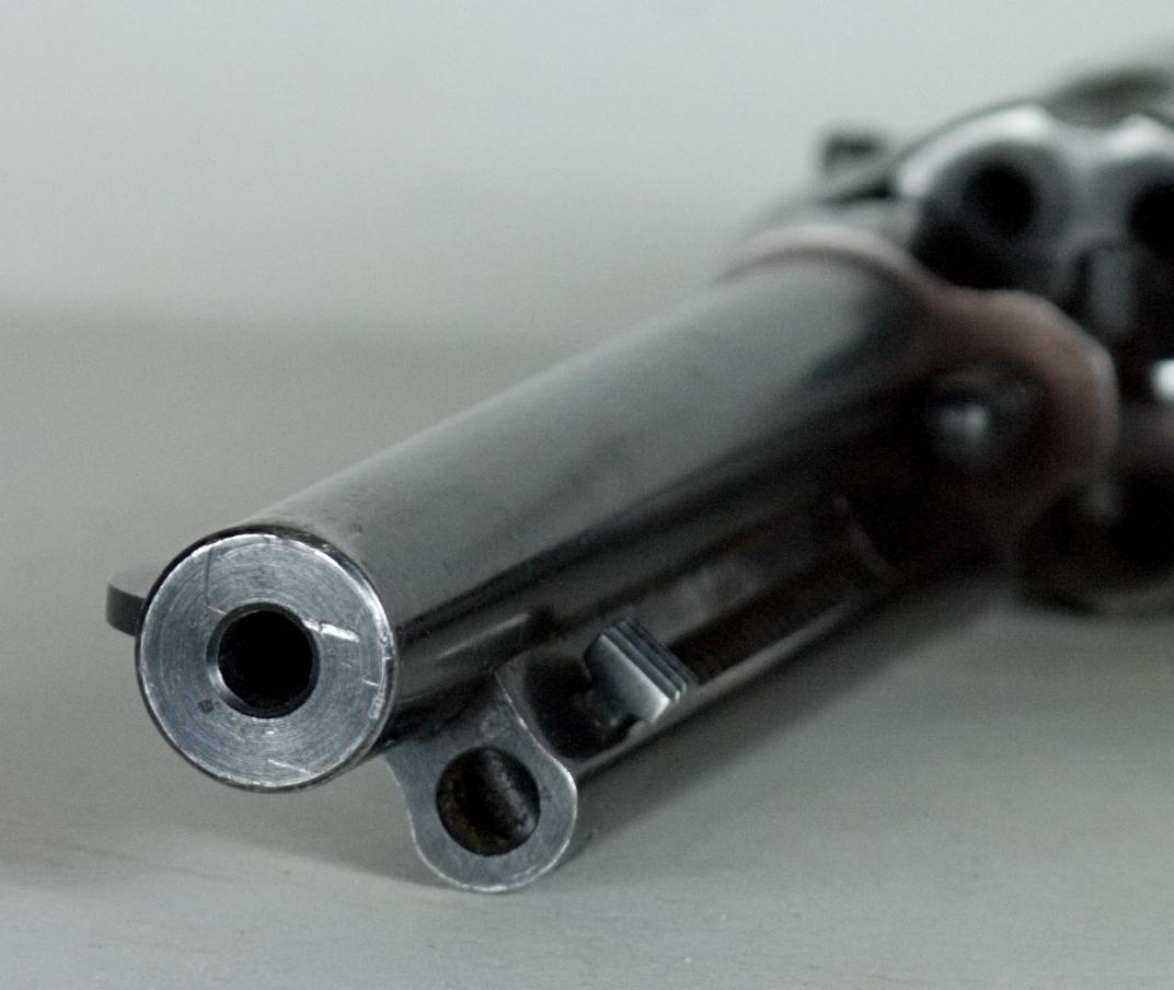

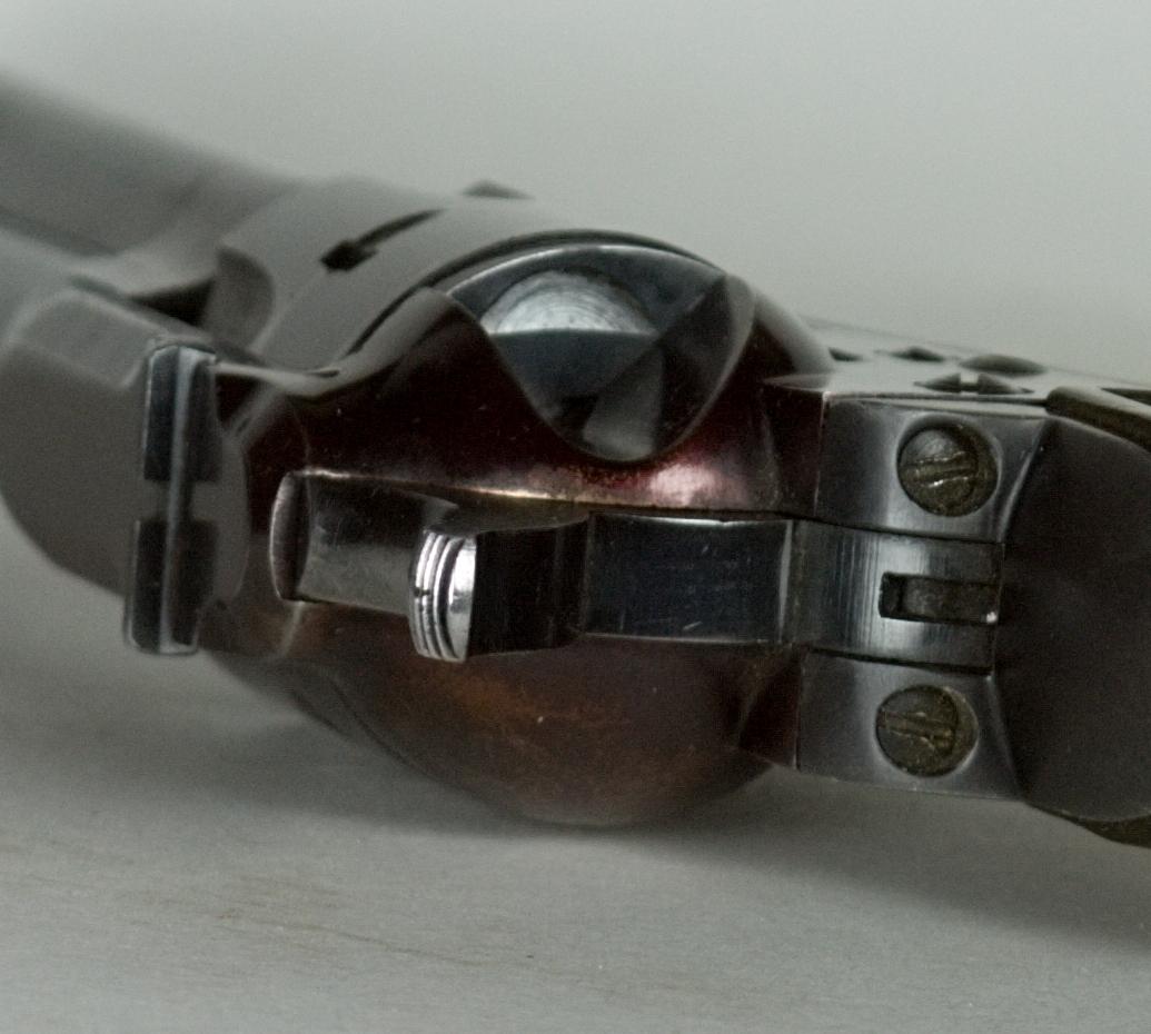

I like low serial numbers, and just bought this one. It seems to have the early features 1. Flat Gate, 2. non-serrated front sight, and 3. the small serrated button on the ejector rod.
These earliest production guns had a number of quality issues. One or more prototypes were made, and during early production other corrections would be identified.

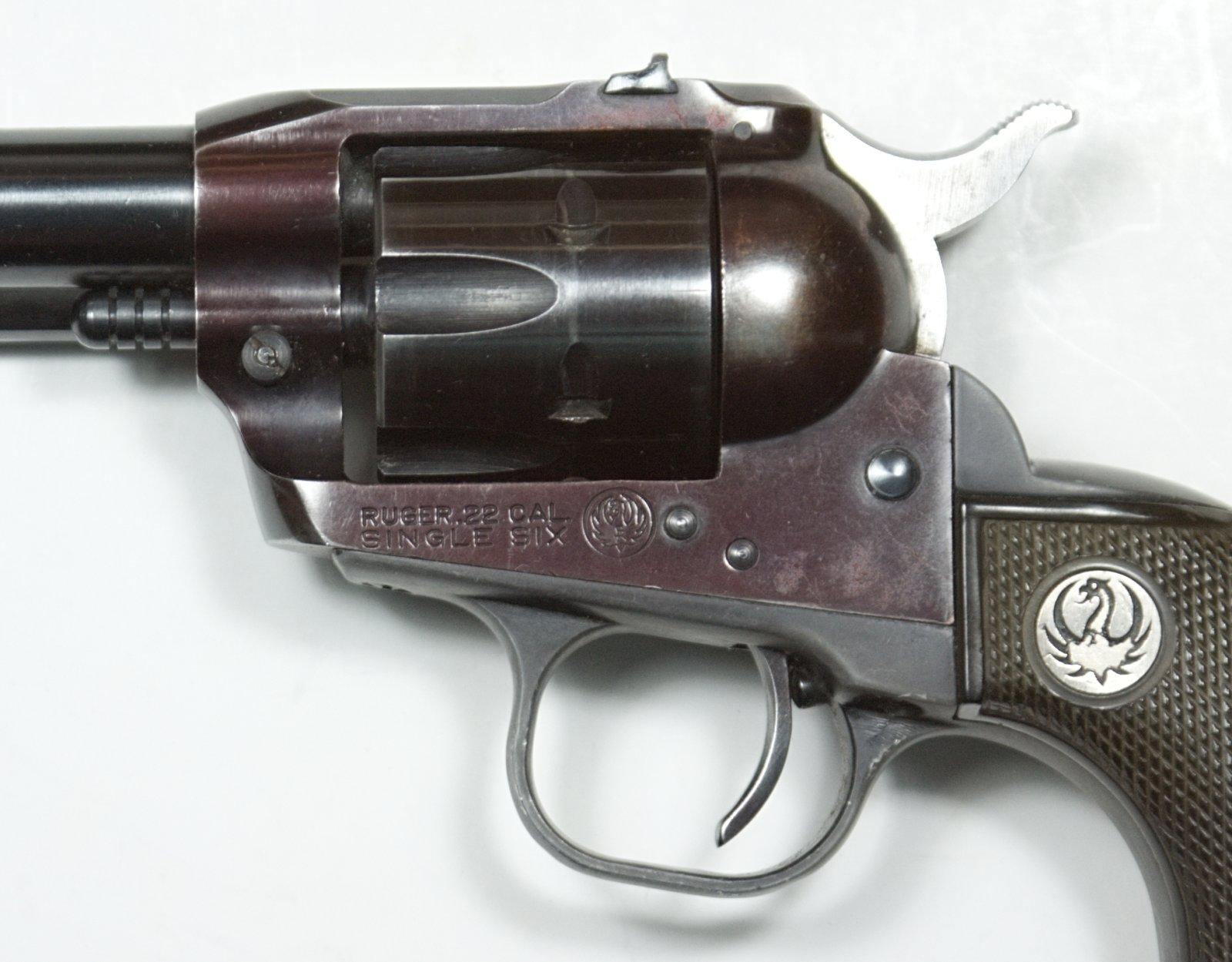

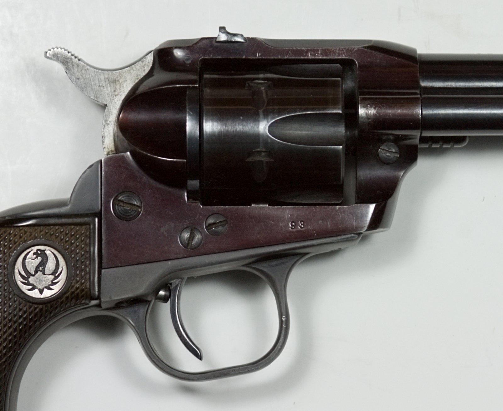

1. One was that the frame blue often "blushed", as seen on the left side of this frame.
2. Another fault that I noticed was the small ejector head, coupled with a tight coil spring, is difficult to work backwards in ejecting shells. Oil had to be applied to make it work at all.
3. in ejecting shells, it was also noticed that the rod head can hang up in the backward position. A rod head installation slot is causing this.
4. The flat gate is very difficult to open, and consumers demanded that gates be profiled like the Colts.

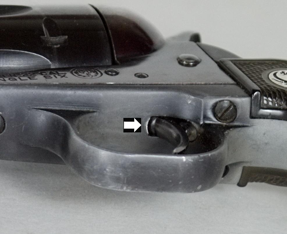

5. When pulling the hammer to the safety or half cock position, the trigger slams forward and hits the trigger guard slot. it has done that enough times to roll some aluminum forward at that location (see picture #10).
However on the positive side, it appears that Ruger managed to get their tolerances tight enough, so that assembly numbers were not required. That includes the barrel, cylinder, and housing.
The ejector housing on this gun is made of Steel. I thought that these later were made of aluminum, but maybe not.

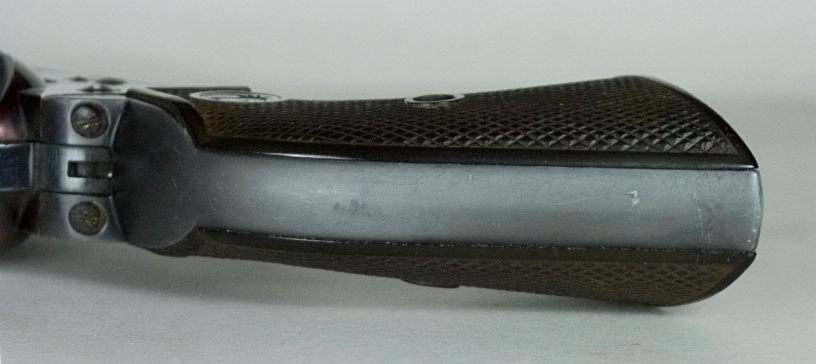

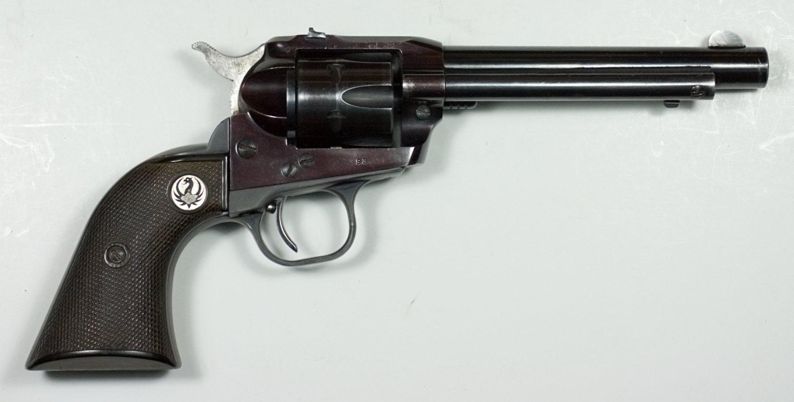

The grips are actually black hard rubber, and not some plastic! One can see on this example, that the butt areas are turning brown, as real hard rubber will.
This one was made in 1953 or 1954. Can I find out when it was made or shipped?
Were any frames (and serial numbers) scrapped during early production?

welcome to the forum and that is indeed a very nice gun, sounds to me like most of the issues are dues to misuse, improper care ,oiling and cleaning of the gun, except for the discoloration, of the cylinder frames content of the 'casting mix' alloy ( 4140 chrome -moly) and causes the part to actually "plum" turn a reddish color the rest is as they designed and built them and it is "how many years old now" like 70 ??!! my, my fine looking pictures of that old girl is how we see it.......practice the how, whys and the wherefores and you'll be just fine, most of us here would LOVE to have that gun "as is"...:cool::rolleyes:;)

(1) The color change was due to the metal blending before casting the frames. Often called "plum" coloring. And is actually enjoyed by many including collectors. When it happened,, and guns got returned,, Ruger would re-polish them, re-blue them, and return them. They eventually changed color again.
(2) You can remove the Ejector rod housing, and GENTLY see if there are any burrs inside the channel that need to be smoothed out.
(3) The hanging up of the ER button is just a little quirk. Later on, the offset clot was eliminated.
(4) Yes,, many found the flat loading gate was harder to open. A company named "Premier" started offering a rounded loading gate as an aftermarket item. Ruger changed from the flat loading gates to the ever popular rounded on & never went back.
(5) The trigger slot,, getting peened a bit by the trigger isn't a big deal. You can open up the slot a little if you wish,, but then you'll have a shiny aluminum spot showing.
(6) The rest of your comments.
Ruger didn't need to number parts because of the assy methods they used. However,, later on,, when they started offering spare cylinders in .22 Mag,, they would use an electric pencil to put the last 3 digits of the serial number on the spare cylinder to assure it went back to the appropriate gun after bluing.
Yes,, the early ER housings were steel. They later on went to aluminum, to save costs.
The grips are a "butaphane rubber" type. But they appear plastic,, and are an early form of plastic type. Again,, a way to save expenses in building. The changing of color has been well noted, and often a result from sunlight exposure. There have been attempts to "re-blacken" them with RIT dye,, but most if us just leave them alone.

According to John Dougans book....................
The 93 was one of the first 14 guns produced, December 15th 1953.
An historic one for sure.
