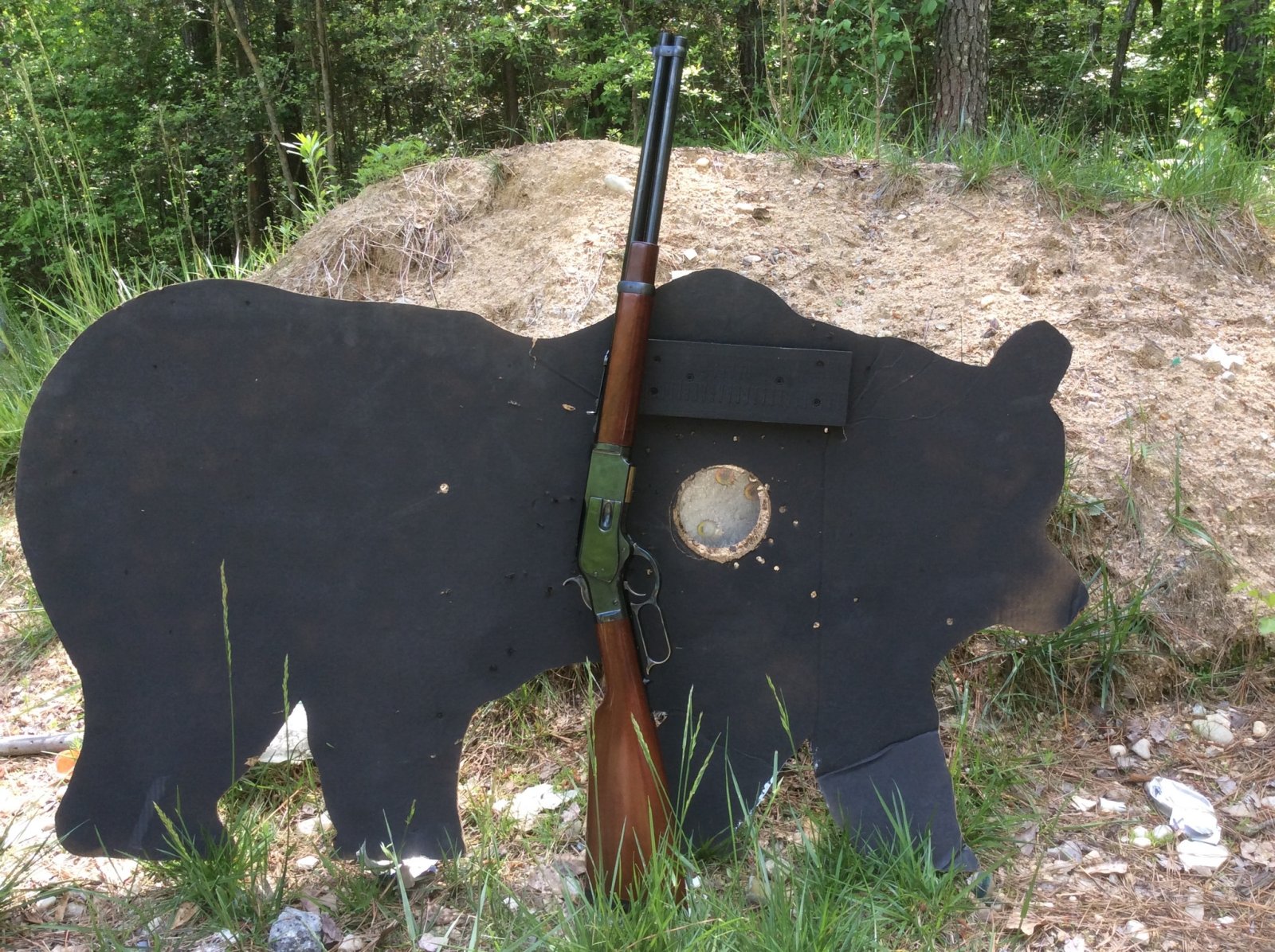

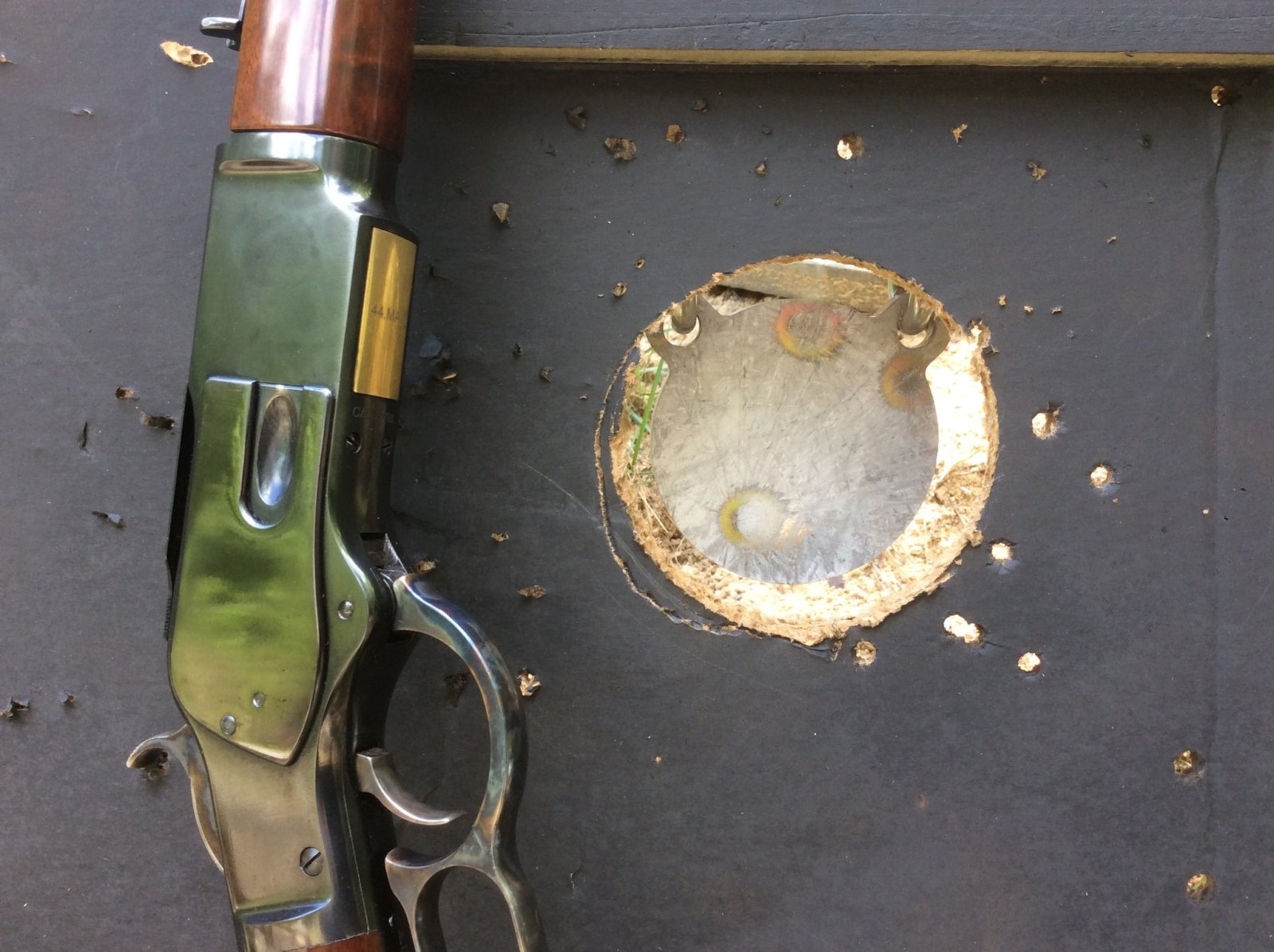

Yes this was intended as a mid level 44 Mag load in a Special case for a COL that would chamber in my 1873 Uberti 44 Mag lever rifle.
Shot some yesterday and they clocked at 1120 FPS which is fine. I could bump it up a bit but did not have load data for it.....being safe!
Shot well from 25- 45 yds. and bore was clean. Shots on Glow Shot target.
