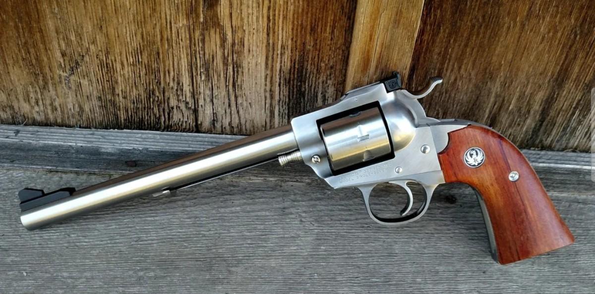

Good looking gun there!
Did you round the heel of the grip frame or buy it that way?
I rounded the frame during the install. Whipped out the ol' angle grinder and knocked it out in no time.
Just kidding about the angle grinder. Started with a coarse bastard file to rough it out and then used less aggressive files finally cleaning it up with sand paper and foam backed buffing pads.

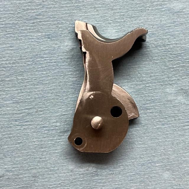

I found and ordered a Power Custom Single Six Bisley hammer and trigger kit after I finished the swap. The factory Single Six hammer is actually about the same height above the back of the Bisley grip frame since the Single Six cylinder frame is smaller than a Blackhawk cylinder frame. Here's a picture of a BH Bisley hammer compared to the Single Six's.
