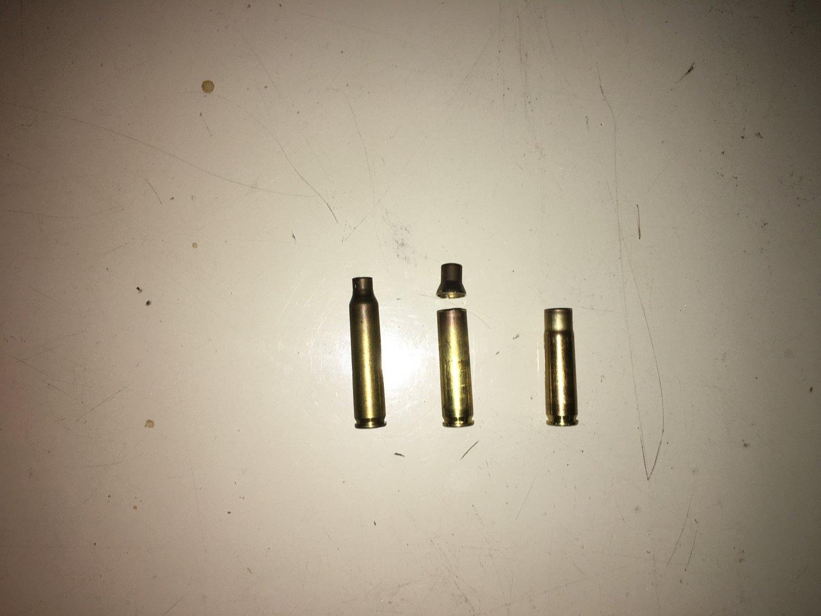

I bought one of those cheap Harbor Freight micro chop saws for about $20 and some cheap-o Lee 300 Blackout dies for case forming and make my own 223's into 300 Blk
