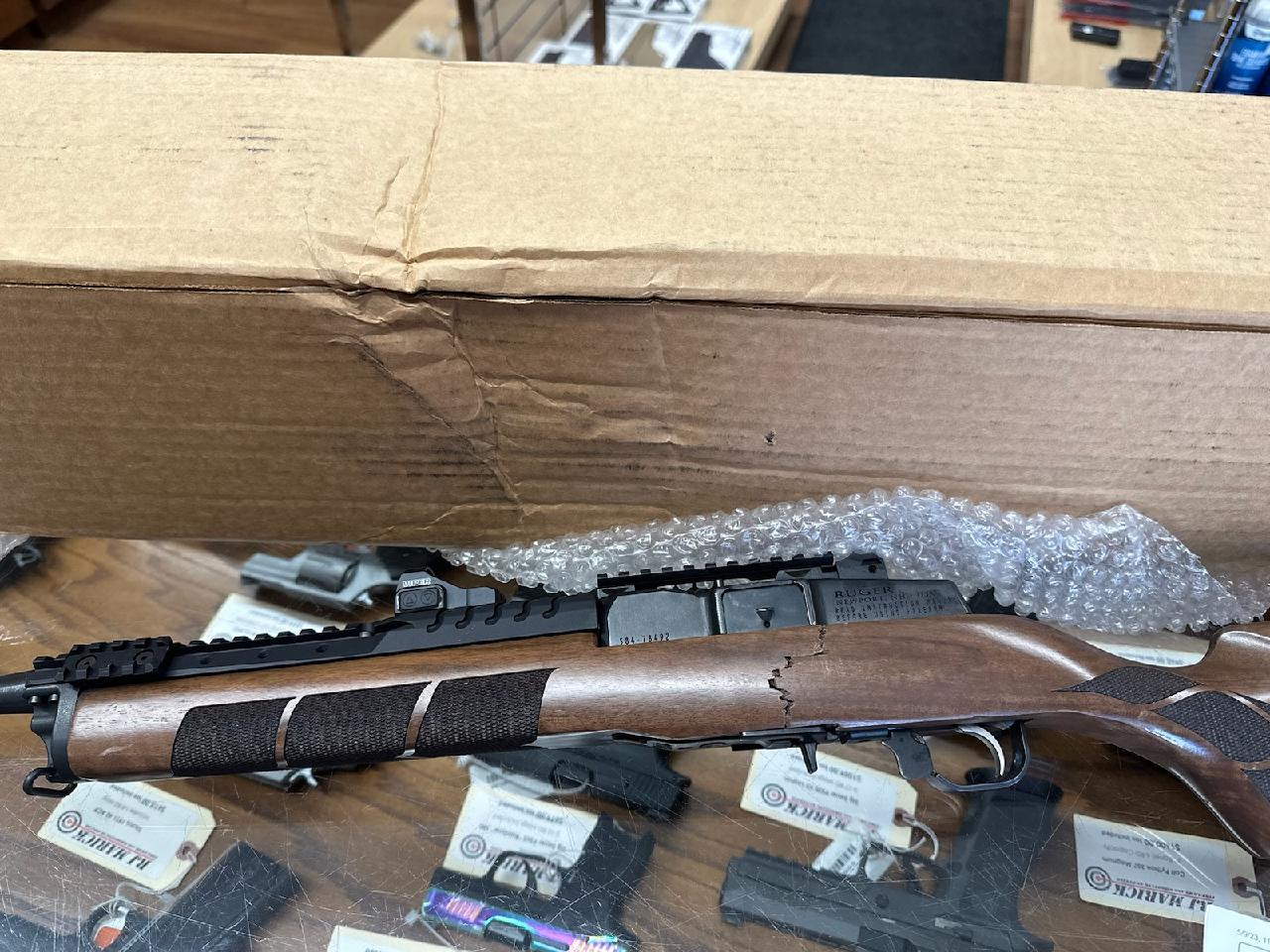

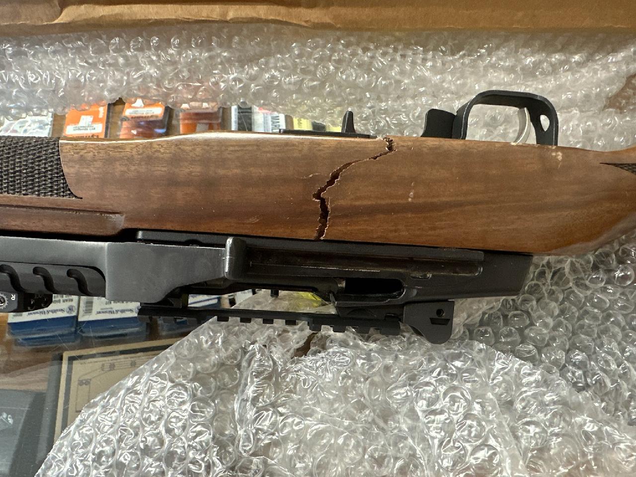

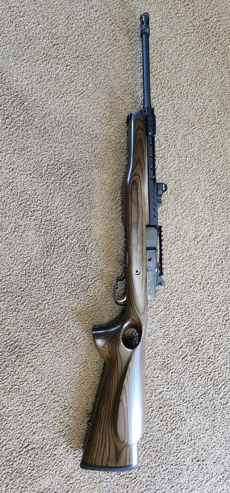

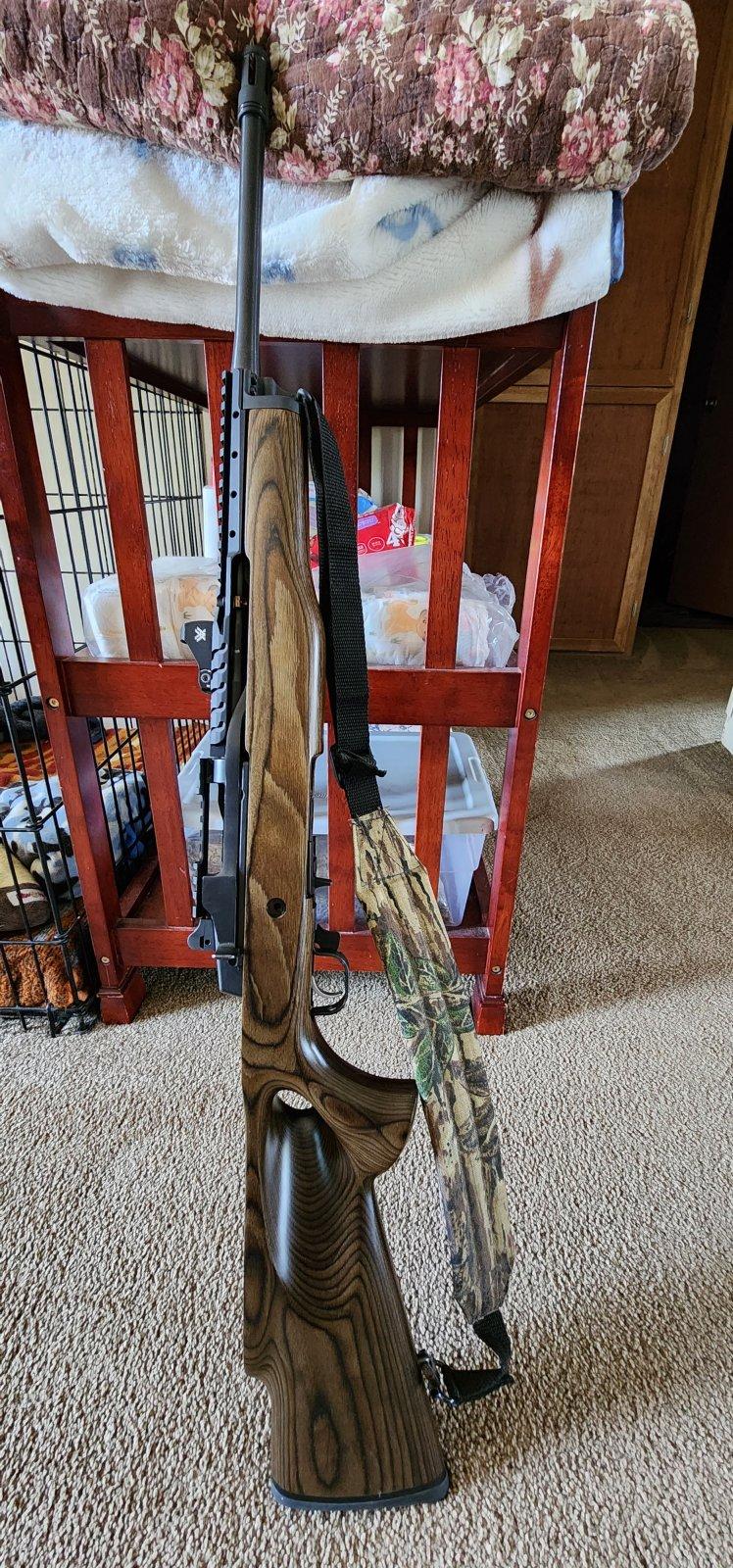

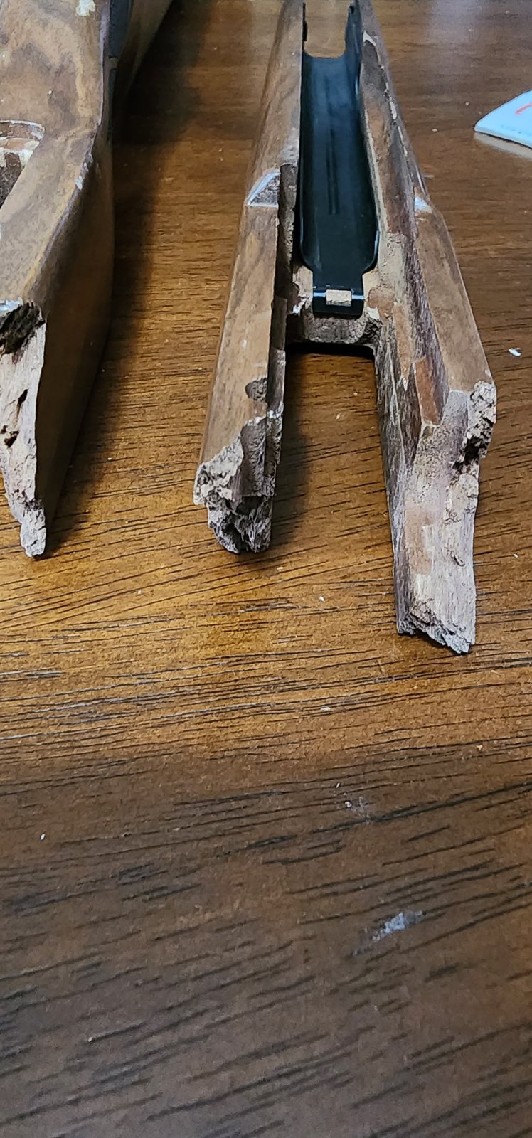

NEED HELP!!!!!! I received my 580 Mini-14 to FFL today and this is the condition he found when he opened the box. ANYONE have a replacement stock for sale in wood? I bought this one partly because of the stock .

that was obviously damaged at some time in shipping just look at the box, pressed on the side, no other way the stock should or would get cracked like that ALL THE WAY THROUGH,,,,UNLESS IS WAS USED A BASEBALL BAT AGAINST SOMEONES HARD HEAD??:cool::rolleyes::sneaky:

I do not think that's a factory configured stock. I do not recall the extra checkering on one like that.
And it appears the gun has had some modifications to it as well.
At best,, you can find A wood stock,, but not one with that checkering. I too would be filing a claim with GB & against the carrier etc.

Along with finding a new stock, I would be extremely worried about the overall condition of the rifle. To break a stock like that, what other damage might have happened?
My FFL is also a gunsmith and he inspected the other components and feels there is no other damage luckily. I'm more pissed that I purchased that particular rifle because of the rare stock and now it is just a pile of fireplace material.

That looks to be a Boyd's walnut stock. They are not inexpensive. Two that crack is from side ways pressure. There should be metal reinforcement there but it is missing as there are no screws through the side of the stock which holds the reinforcement in place. I can't imagine Boyd's would not have included the holes so I may be wrong but that is why that stock cracked that is the weekest part of that stock
Yeah, It is a Boyds stock. I went to their website and priced a new one exactly as this is and it is almost $520... DAMN!

That's majorly F'ed!!! +1 on the UPS driver. I can't imagine the barrel and or the action not being "Bent" even if it's a few thousandths that would make the barrel nearly useless. Of course these things aren't particularly accurate to begin with.

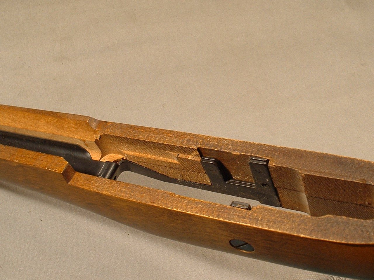

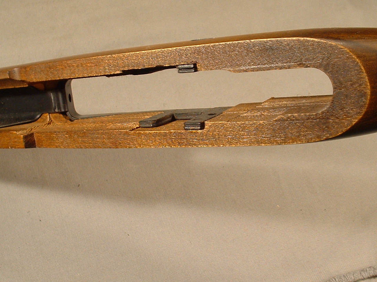

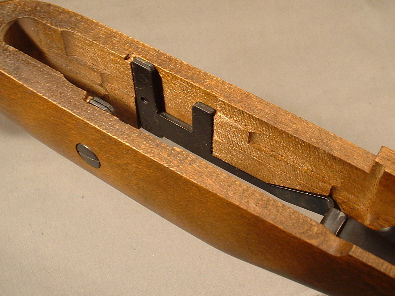

Jeff is are some quicks of the MIni-14 stocks I have here like I said the older NOT the early shallower 180-181 stocks and this one has the blue metal liner liner 4 parts, 2 screws, the mag well support and the liner with the hook tabs for the foreend tip....
