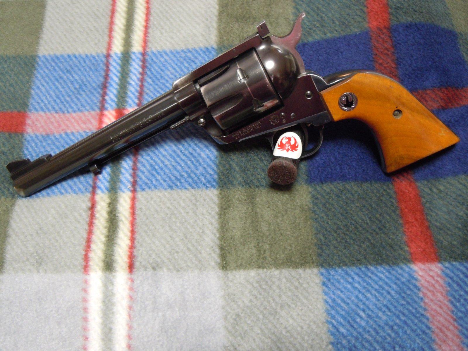

Great buy! If it's a shooter you'll enjoy shooting it much more with a steel XR3-RED grip frame. More knuckle room and more weight in your hand for better balance.
The blue steel (or stainless) grip frame from a Ruger cap and ball Old Army will interchange. And you can use the wider trigger as well.
An old model super blackhawk wide spur hammer is another great addition; also interchangeable.

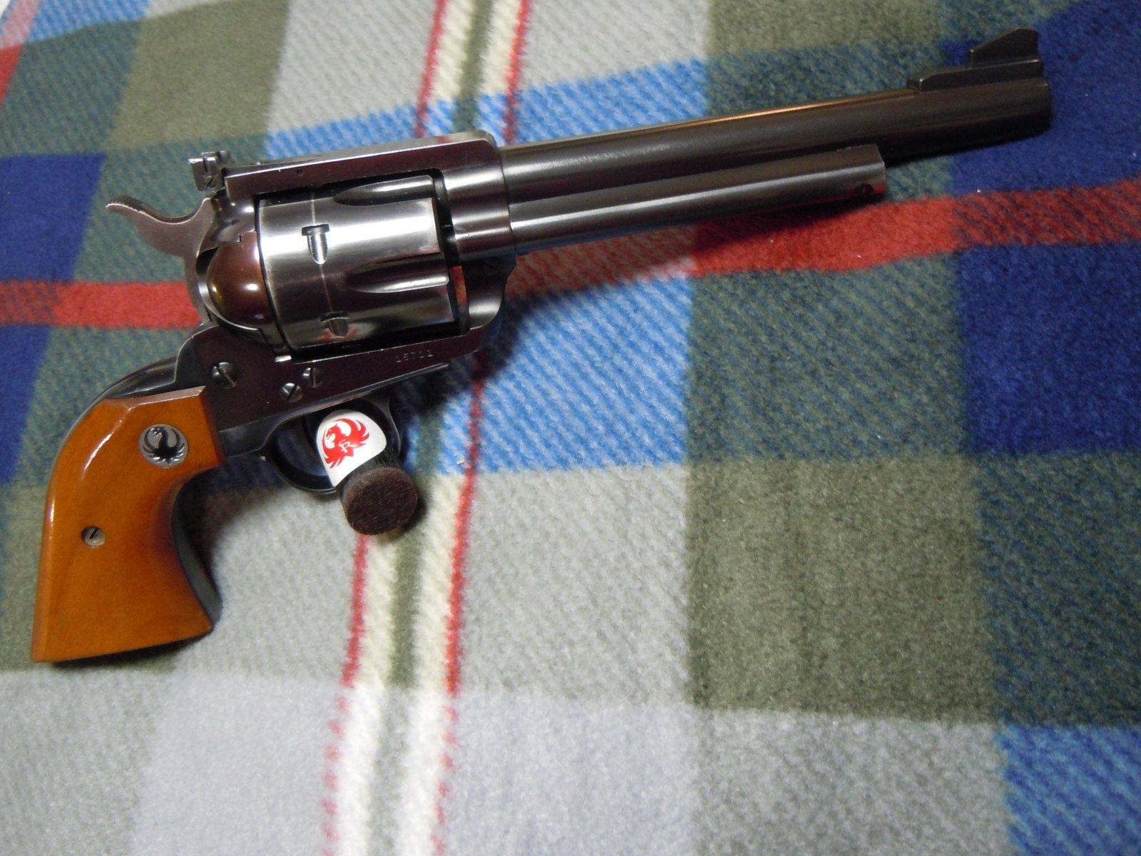

The slot of the ejector housing. Does it go straight back to the frame without an "offset" just ahead of the cylinder base pin?

I'm not a knowledgeable collector, but I believe the "offset" Chet is refering to would appear/occur at the beginning of the ejector rod. Here is a picture of mine that does NOT have the offset housing...As you can see, mine is a "straight back" type housing on my 1959/1960 FT 44 Mag.
Hope this helps.... Chet, correct me if I'm wrong....

Welllllll……. I picked up the flat top today. I am embarrassed to say it is missing the base pin latch assembly.
With no further explanation, I need an assembly appropriate to this model.
Does anyone have a link to where I might find one?
Otherwise, I am happy with the revolver and look forward to being able to shoot it. I am currently on the road and look forward to finding the parts.
