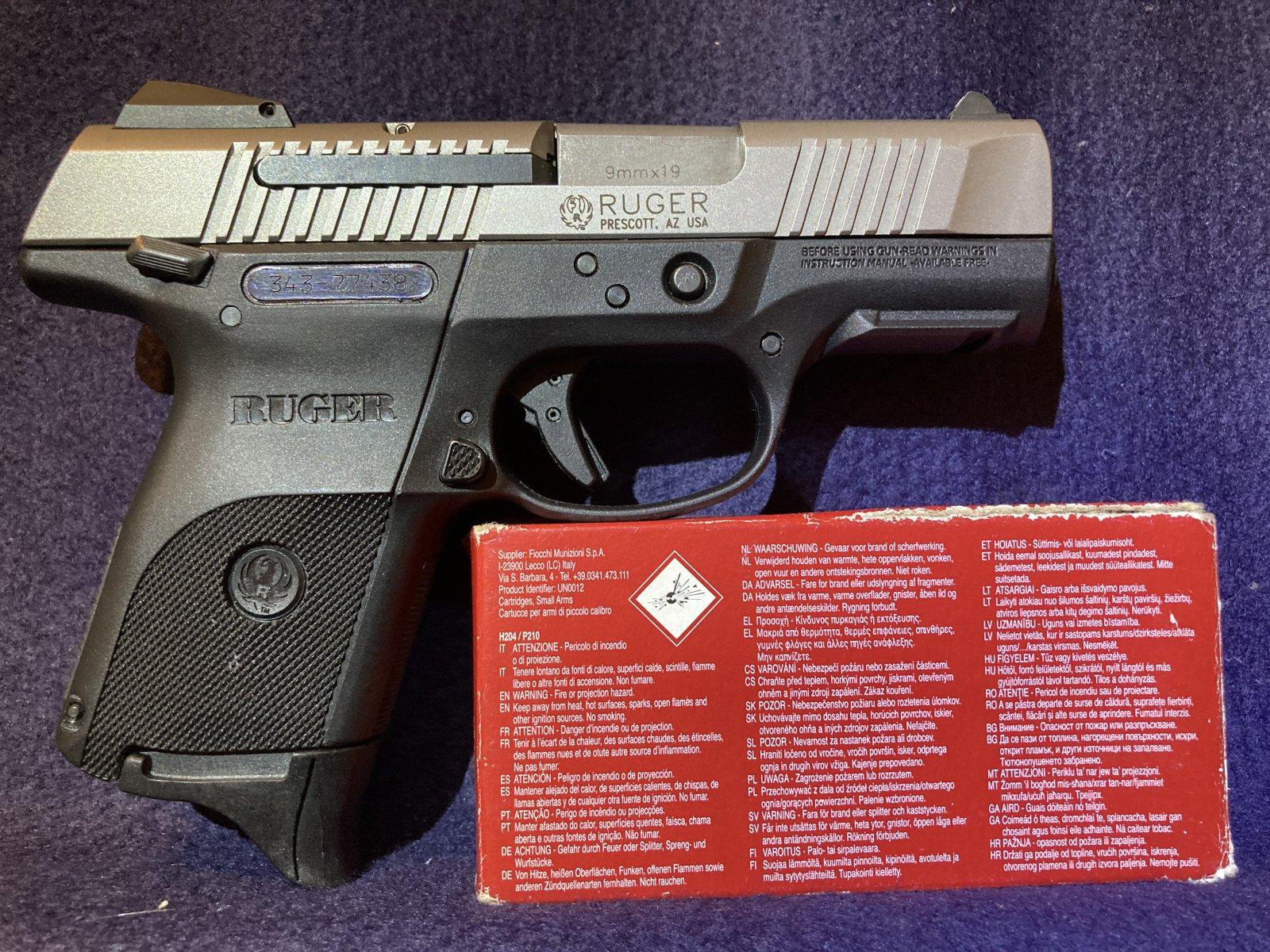

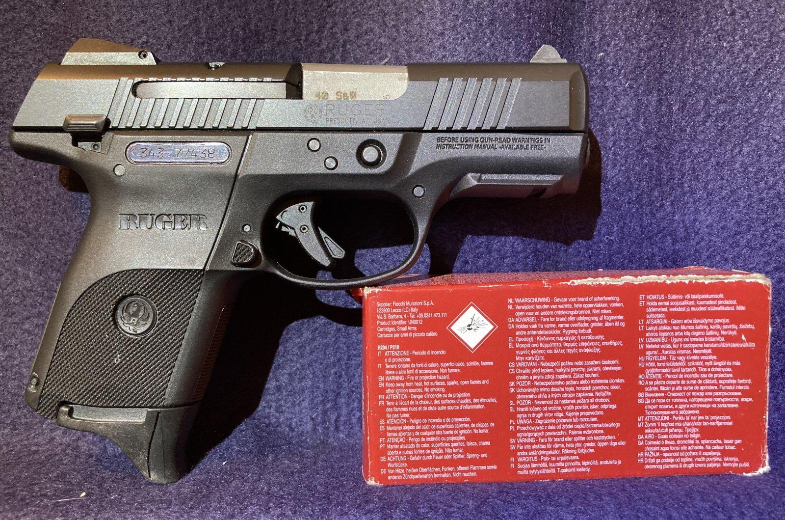

The SR9C slide and barrel drop on to the 40 frame perfectly. Uses the same recoil spring assembly, but for $8.00 ordered a separate one.
The 9mm barrel drops in and functions fine (snap caps) with the 40 slide. But I figure for the few $$$ more and that it's nice looking stainless, got the 9mm slide. I added s stainless FP spring guide rod, cleaned up the spring and plunger, mag disconnect same as the 40. Nice to be able to use the same lower with the 9mm upper.
