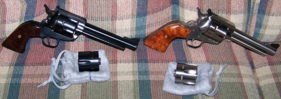

only .45 convertible I have is this '71 old model 4-5/8" barrel
seems to prefer lc over acp but fun to shoot with both
up in the 5-7 yard range slow fire it does well with both but the lc is still slightly tighter than acp

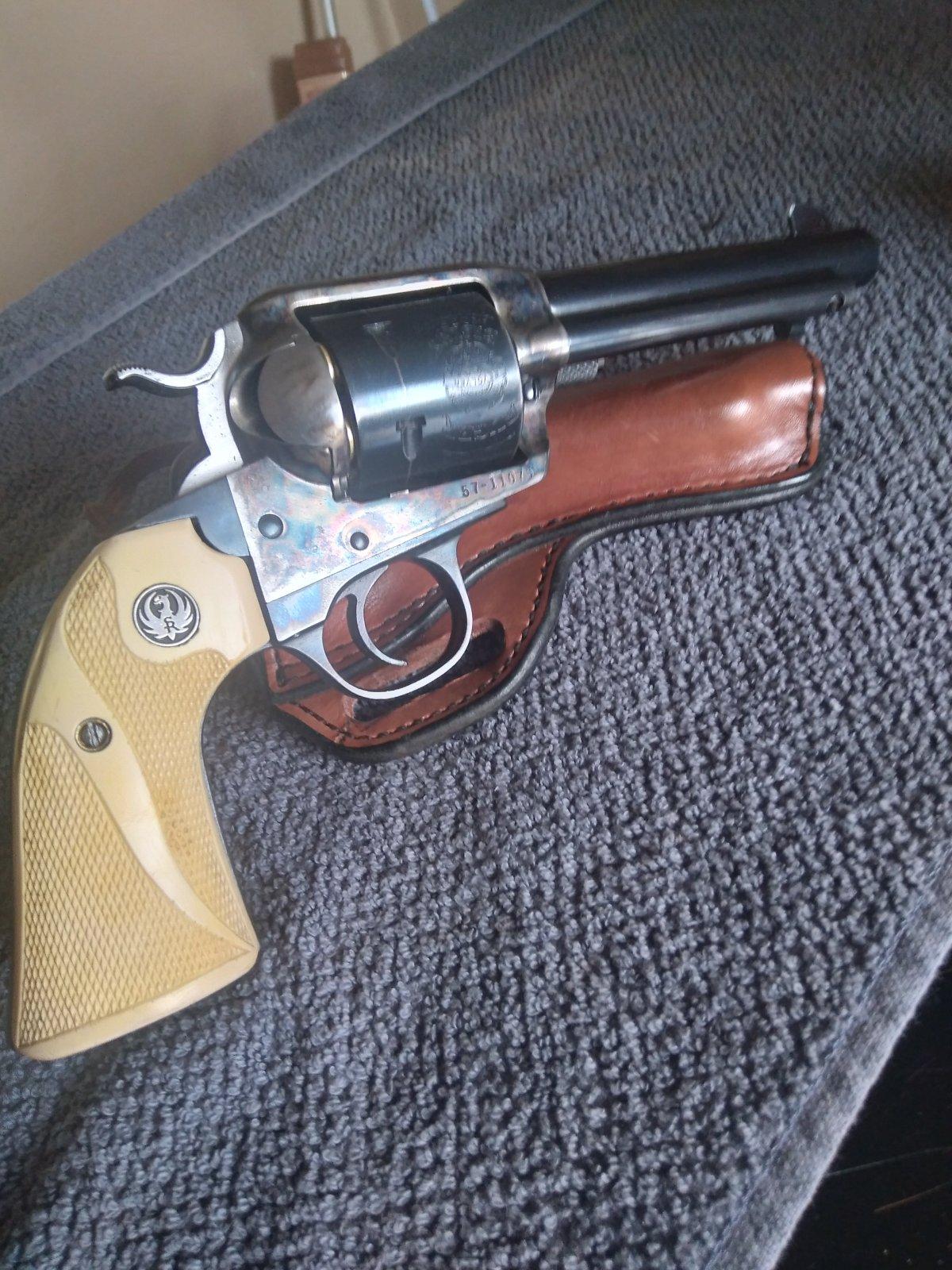

Pleased as I have been with 45Colt/45ACP revolvers, I have a Sheriff's Birdshead New Vaquero in .45ACP only, and the accuracy is quite good. I will never miss the .45 Colt capability for this tiny revolver.

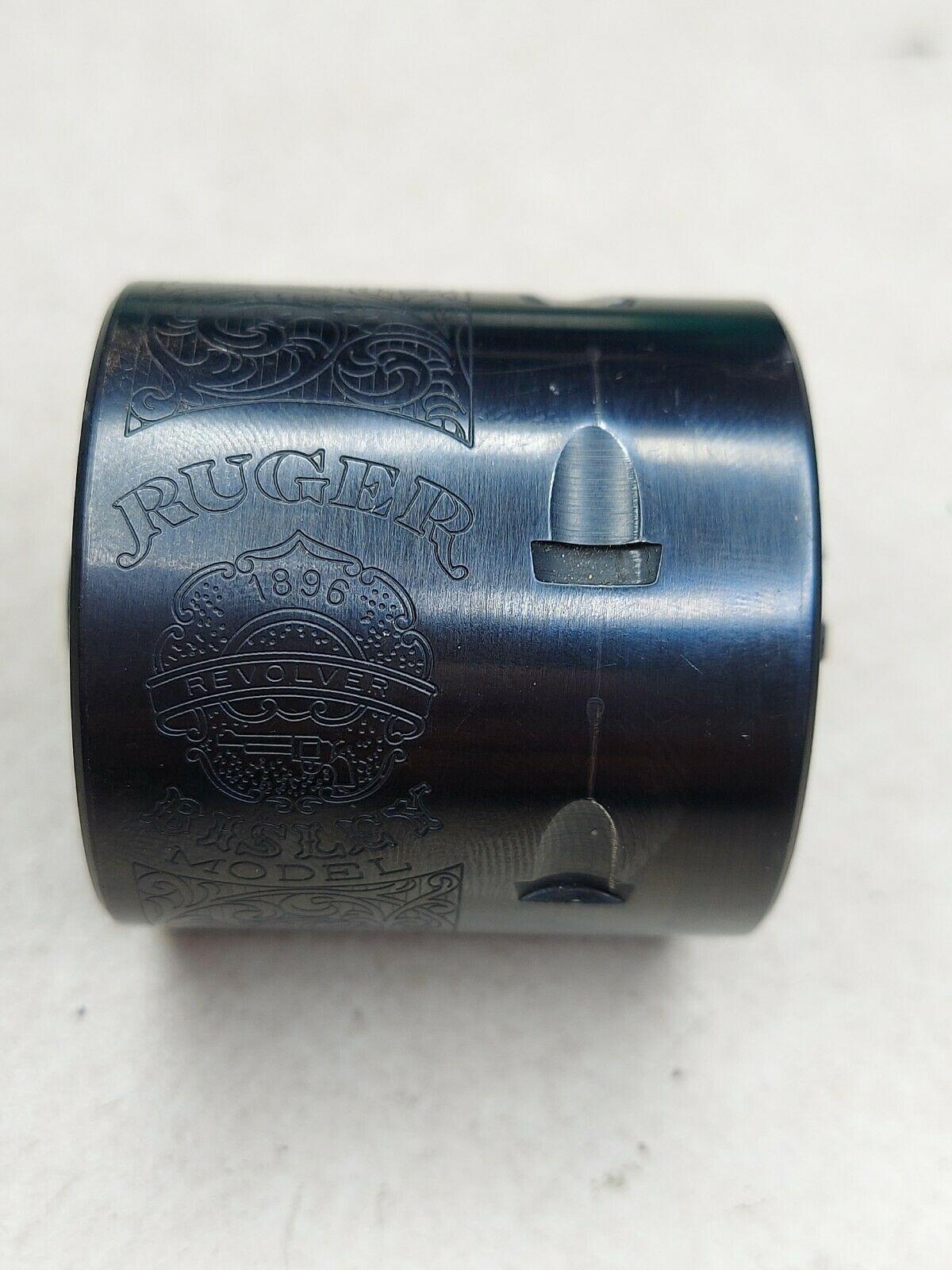

I am looking for a 45 ACP cylinder to go with my 45 Colt Bisley Vaquero.
I am also looking for an unfluted Bisley cylinder in 45 Colt. I tried out the unfluted cylinder from my 7 1/2" Bisley Blackhawk and it worked good, timed well in my 5 1/2 BV but my 45 Colt cylinder from my BV would not turn on cocking in the 7 1/2 frame gun
I put the unfluted cyl in the 5 1/2 for this picture
But recently sold the 7 1/2 with the correct cyl.

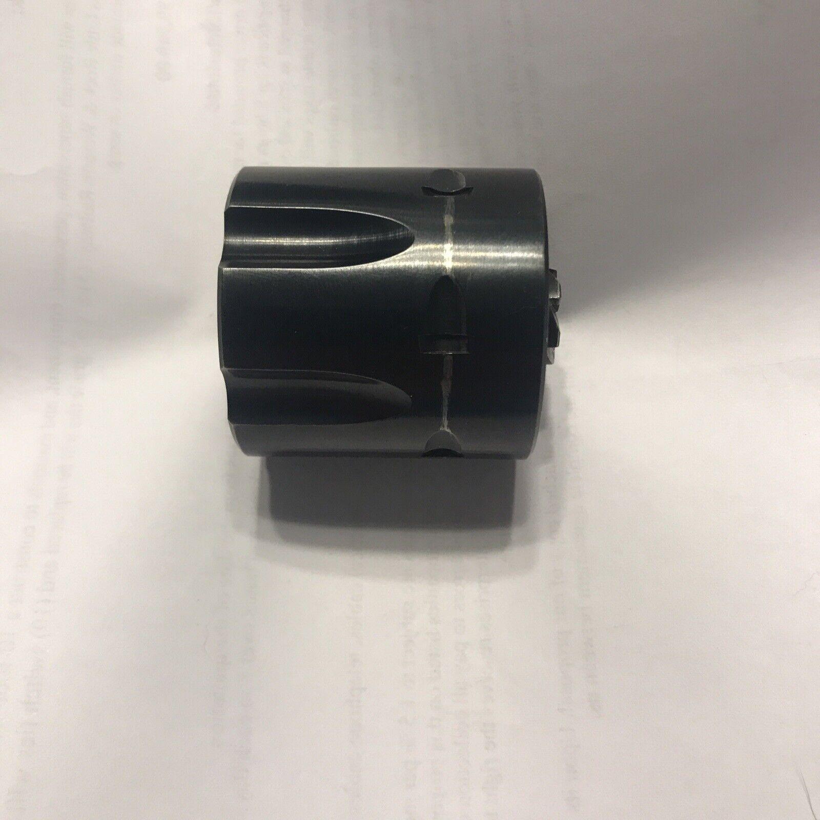

Lucked into this Bisley 45 Colt cylinder for my converted Blackhawk Convertible. Also bought a Blackhawk cylinder advertised as a .44 mag, ended up being a .45acp! fits my original Vaquero and functions fine. Both under $100 each, they are out there.
