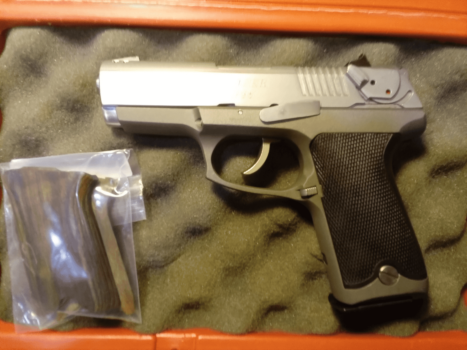

I too have an early P85 still new in box. I remember when the P85 Stainless came out, the first thing I noticed handling it was the slimmer grips on the frame. It made a nice difference. 🙂
